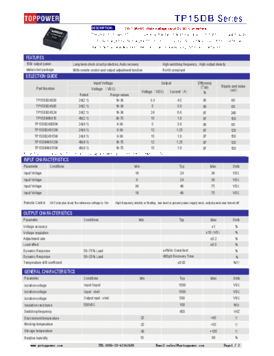

Preview for : TOPPOWER TP15DB 15W 1.5KVDC Wide Voltage Input DC/DC Converters
15W output power Long-term short-circuit protection, Auto recovery High switching frequency , High output density
Metal shell package With remote control and output adjustment function RoHS compliant
SELECTION GUIDE
Part Number Input Voltage Output Efficiency
(Typ)
% Ripple and noise(mV)
Voltage (VDC) Voltage(VDC) Current(A)
Rated Range values
TP15DB24S03 24(2:1) 18-36 3.3 4.5 85 60
TP15DB24S05 24(2:1) 18-36 5 3.0 86 60
TP15DB24S24 24(2:1) 18-36 24 0.6 87 240
TP15DB48S15 48(2:1) 36-75 15 1.0 87 150
TP15DB24S05W 24(4:1) 9-36 5 3.0 86 60
TP15DB24S12W 24(4:1) 9-36 12 1.25 87 120
TP15DB24S15W 24(4:1) 9-36 15 1.0 87 150
TP15DB48S12W 48(4:1) 18-75 12 1.25 87 120
TP15DB48S15W 48(4:1) 18-75 15 1.0 87 150
