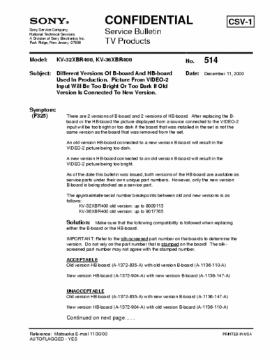

Preview for : Sony KV-32XBR400 KV-36XBR400 Symptom: There are 2 versions of B-board and 2 versions of HB-board. After replacing the Bboard
or the HB-board the picture displayed from a source connected to the VIDEO-2
input will be too bright or too dark if the board that was installed in the set is not the
same version as the board that was removed from the set.
