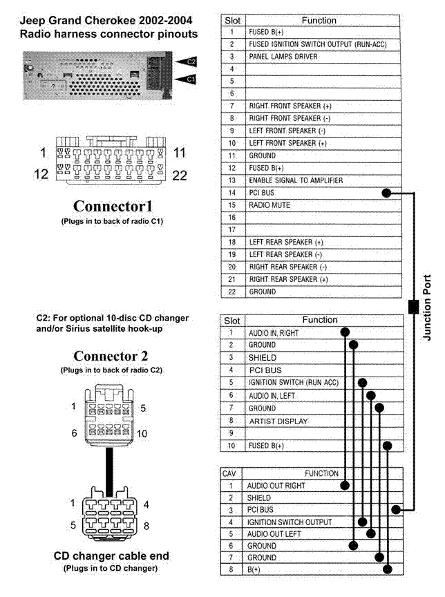

 Description : Jeep Grand Cherokie 2002 - 2004 Radio harness connector pinouts
 Pinout :
PinNameDirectionColorDescription
1see pictursee picture
 Note : Jeep Grand Cherokie 2002 - 2004 Radio harness connector pinouts
